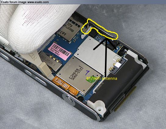

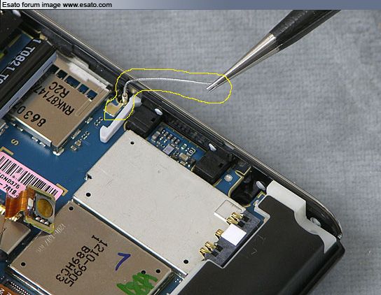

Huh... Funny you mention that because the wifi/bluetooth antenna and microchip are right behind the fastport and memorycard slot.
From the dissassebly manual
