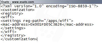

My WiFi shows a mac address of 00-00-00-00-00-00 and searches but never finds a network, after searching the web I found this post on another forum,
 I found this post on another forum:
 Here you go guyz
 Save the below code as customize_upgrade.xml using notepad.
 Use fsmanager script to access phone's filesystem. Copy to
 tpa/preset/custom. WiFi should now be fixed.
 0x001FD05C3B26
 Try it !
 Has anyone else tried this? If so how do you access the file system of the phone and put in this script?
 -Ash |

dobrizmaj87 Joined: Jun 09, 2010 Posts: 37 PM |
founded solution for problem, my wifi finally works
 open notepad and write following code:
 now save file as customize_upgrade.xml
 copy this file to tpa/preset/customize via a2uploader and enjoy
 [ This Message was edited by: dobrizmaj87 on 2010-07-01 15:22 ]  |

 Sorry for bringing up an old thread but I did this and I managed to change my mac address from 0-0-0-0-0 but I still can't find anything with wifi   Any possible help? |
