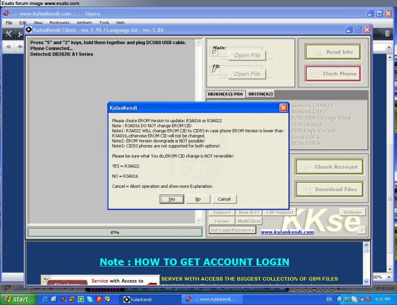

use KulanKendi to fix your erom. its free.

Press "5" and "2" keys, hold them together and plug DCU60 USB cable.
Phone Connected...
Error: No response.Remove battery and put back.

Posted: 2008-10-31 15:33
What to click Yes or no ?
Posted: 2008-10-31 15:41
press NO. if yes your phone'll be CID 53 and wont be patchable
Phone Connected...
Detected: DB2020: A1 Series
Flash ID: 0x897E - Supported
EROM CID Detected: 52
Status:3
EROM Update Ok!
All Done! - Time:00:00:05
And when i turn on it`s still blinking.
Do i need to flash main and fs?
Posted: 2008-10-31 15:48
yes, flash the main and fs again. please, could you tell me what files(FS and MAIN) are you using?
