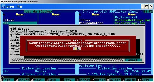

Posted: 2008-07-19 16:31
Was working til i got this error:
it was 'starting FS server'
Any ideas on where to go from here?
k810i
strizlow800
G900 Brown
Joined: Aug 23, 2006
From: Macedonia, Skopje
Posted: 2008-07-19 16:52
Try again from the beginning to see if it work...
Make sure you have the latest and most stable version of jdflasher plugin...
hfmls
Joined: Mar 17, 2008
Posts: 489
Posted: 2008-08-14 09:27
well you couldn't do it because u have to choose db2020 and max connection speed and correct cable model....
