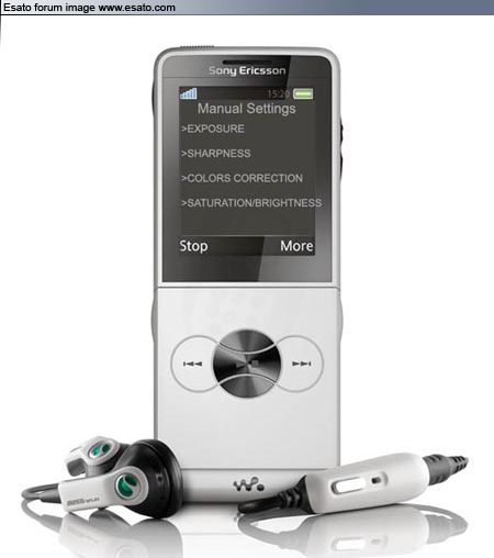

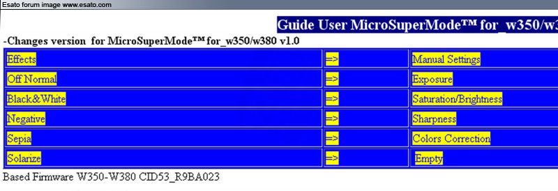

MicroSuperMode™ for OmniVision 9660 v1.0 w350/w380
How to use this MicroSuperMode:
The menu effects was replaced by menu manual settings.
Choose appropriate Manual Settings, a choice of menu functions.
Changing EV: in menu choose Manual Settings, choose EV, with joypad you can change its value.
Manual Settings with 12 steps use joystick/joypad for change the functions and steps
Effects=>Manual Settings
NORMAL=>EXPOSURE
NEGATIVE=>SHARPNESS
SOLARIZE=>EMPTY
SEPIA=>COLORS CORRECTION
BLACK&WHITE=>SATURATION/BRIGHTNESS
ATTENTION:
ABOUT MICROSUPERMODE™
The functions in a microsupermode are not accumulated.
The functions don´t work together.
