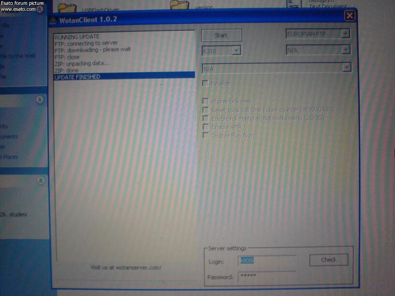

get a printscreen and post it here. it should d/l the erom and the upgrade yours
Leeky Joined: Oct 05, 2007 Posts: 18 PM |
Sorry, dont know how to post a screenprint.
How long should it take?
I have plugged an old K750 in and that came up for the firmware upgrade etc, so i know the program is running correctly, I just cant get my K800 to switch on!! |
