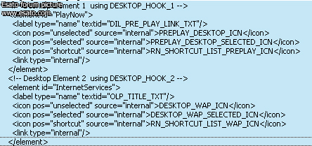

well if it is about customization pack then i remeber my cuztomization... and put the same one ... but there is no Play Now |
SSyar Joined: Aug 12, 2007 Posts: 42 From: Karachi, Pakistan PM |
<!-- Desktop Element 1 using DESKTOP_HOOK_1 -->
~~~~ <element id="PlayNow" replace="next"> ~~~~
<label type="name" textid="DIL_PRE_PLAY_LINK_TXT"/>
<icon pos="selected" source="file">icon1_selected.gif</icon>
<link type="internal"/>
</element>
<element id="OperatorWebPage" >
<label type="name" textid="SONYERICSSON_TXT"/>
</element>
omiting replace ="next" didnt work either...
any suggestion!?

Hrc4u Joined: Aug 15, 2006 Posts: 59 From: sweden PM |
hi!..
modify the menu.ml too look like this...it worked for me:
i also removed the element id="OperatorWebpage"..
don't know if it is necessary though.....
regards/H
well strangly enough...its not working for me man... :s |
i think its cust pack which is making the problem... while putting the customization from XS++ i check the option of 'dont upload se wap links'... after that there are no wap links in GAMES, THEMES, PICTURES & SOUND.
it may may have also remove the internal link of PLAY NOW...
though i reinstall the customization without cheking the 'dont upload se wap links' but still no luck for me..
and also i dont get the wap links back in GAMES, THEMES, PICTURES & SOUND.... |
well well well.... dload this http://www.topsony.com/forum/[....]nks.php?catid=791&linkid=11929 script file(s) from Top Sony to make it all in the end..
Now i got my PlayNow
