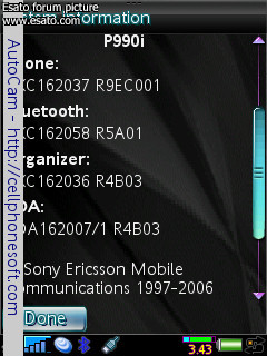

spectre77
P990 no flip
Joined: Jan 28, 2007
Posts: 42
From: Malaysia
Posted: 2007-02-19 05:03
On 2007-02-18 23:44:33, seunlock-uk wrote:
If you select the finalise option you should only get one CDA string which is a much better way to do it as it limits the errors that can occur through having multiple CDA strings.
@seunlock-uk,
Tried to flash my cda again last night. This time with the change cda and finalise box checked. A popup window came up saying that you can only finalise with the flash firmware. So, tried again, this time only the change cda box checked. Went through successfully. Like before, i have 2 cda lines after the flash. Then i did a master reset and ran seus. Seus recognised my phone as world 1 generic. And the weirdest thing happened. Checked the info on the phone again. This time i only have 1 cda line as it should be. And my phone version is now r9. And yes, it did cost me another credit. Luckily i had bought an extra credit before. I was happy with the 2 cda lines before. But now, i am very very very happy! The reason i reflashed the cda again is because you said that there might be complications later on. Am so glad i listened to you. So thank you seunlock-uk! Much appreciated. By the way, i will post my screenshot when i go back home. Am writing this post using the newly flashed p990 via 3g. Later guys.
@adara,
Sorry. Almost forgot about your question there for a minute. Lol. Am just so exited at the moment. You only need to check the change cda box. And fill in the desired cda. As for me, i chose cda/1. But followed dominiques' instructions and it worked like a charm. What i did was:
1) format the phone
2) master reset
3) took out simcard
4) replace battery
5) check change cda box with the cda162007/1 typed in it
6) click flash phone
7) press c button
connect usb
9) cda change done (at this time, you will see 2 cda lines)
10) master reset phone again
11) flash with seus (seus detects phone as world 1 generic)
12) done!
But i did another master reset and ran seus again just to be sure. (i'm just being paranoid). So there you go. Happy flashing (you know what i mean). Lol. Hope everything goes well for you.
this is my screenshot with 1 cda line:
[ This Message was edited by: spectre77 on 2007-02-19 05:50 ]
[ This Message was edited by: spectre77 on 2007-02-19 19:47 ]
