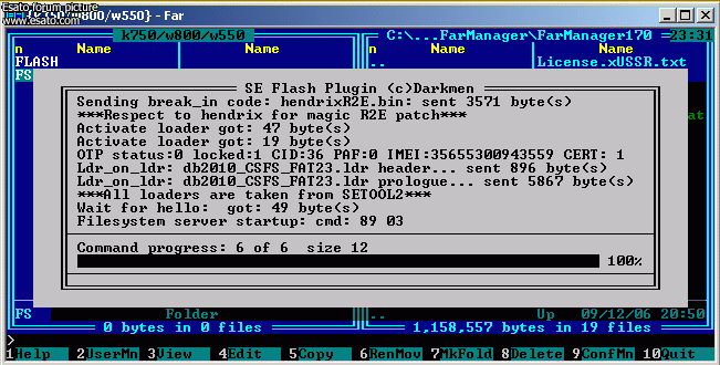

Any ideas while the loader stops here? I flashed with K750_R1CA021_MAIN_EU_1_CL_RED36.mbn and K750_R1CA021_FS_EMEA_3_RED36.fbn . I wrote the GDFS and entered FS in order to add the custom files. It just stopped here for all the 4 times I tried. Can anyone help? Thanks! |
