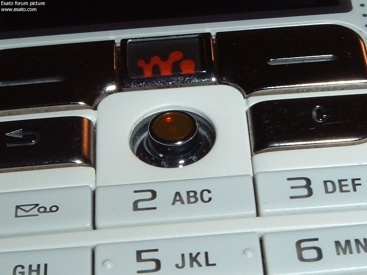

Replacement joystick arrived today with memory stick cover. Pretty quick delivery. Installation was a snap - unscrew the two screws under the battery and then use something to ply front cover off - I used a guitar pick. When I removed the old joystick I noticed it had a rubber dust seal attached to the underside. The new joystick doesn't come with this. But it is easy enough to peal the rubber seal off the old joystick and stick onto new one - better than dust getting in! Any way it's all in and looks much better than the old broken joystick. I also used the MS cover that came with the joystick as it is a better fit than the original. i.e. it doesn't bulge outwards. For those who are considering the same thing I have attached a picture of the new joystick(installed) so that you can get an impression of what you will get if you buy one.
