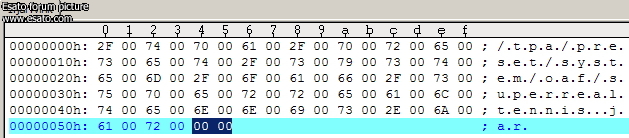

>>3.1. open UltraEdit (download a trial if you don't have one)
>>3.2. write in the path to the file on the phone you wish to extract, e.g. /tpa/preset/system/oaf/superrealtennis.jar (on K700)
>>3.3. save NOW the newly created file with double file extension, e.g. 1.jar.vlnk, in "UTF-16 - NO BOM" format (say 1.jar.vlnk)
>>3.4. press Ctrl+H to enter hex edit mode
>>3.5. append "00 00" (hex) to the end of the file
>>3.6. save again and exit UltraEdit
Your final 1.jar.vlnk should look like (for superrealtennis.jar on K700):
(The appended "00 00" is highlighted in blue by me.)
