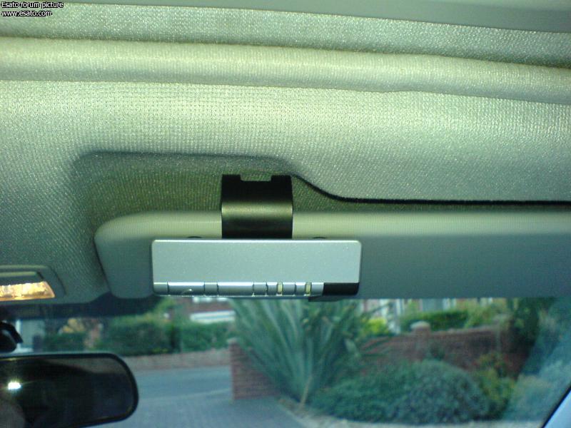

can anyone post a picture of the visor clip?

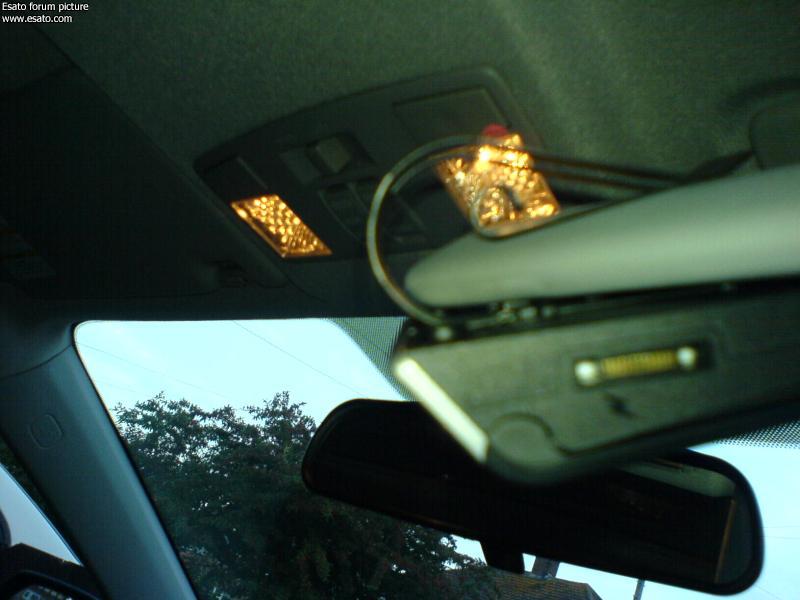

wobbly_rider Joined: Sep 20, 2005 Posts: 18 From: Gloucester, UK PM |
I hope that the pictures work. I can't answer the duplex question, as I normally just listen to the 'missus rather than talking back !
My car is a Mazda6 - not a small car. Presumably "average" depth visors: you can see that the height of the clip stops the visor folding up as far as it should. Not the end of the world, but unnecessary. Volvo_Man, are your visors thicker than mine?

volvoman Joined: Dec 15, 2002 Posts: > 500 From: Cumbria, England PM, WWW
My vehicle is a Nissan Primastar ( Renault traffic/ Vauxhall Vivaro ) 8 seater Taxi, and there is no drooping of my visor. They do seem a bit thicker than the other cars I have, but for the least vibration on the move my Silver Shadow 11 is the best of the lot, mainly due to the visors needing allot of effort to pull down. The worst is my XJ40 XJ6 which does suffer a bit of drooping on the visor. My wifes 06 Micra has very thin visors but they do not droop, and the clip holds the kit very still on these thin visors. Will take pics later or tomorrow as it is getting dark now, will take pics in all the different vehicles for you.
