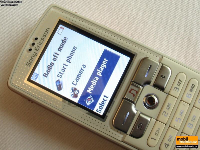

from GSM Arena:

RE:mcrosser's post
How the heck did they get the Camera option in the flight mode menu?!

kristianm Joined: Aug 12, 2005 Posts: 490 PM, WWW
Looks like an old K750 firmware to me.
(My W800 has a different icon for the music mode, and it reads "Music only" instead of "Media Player".)

iainkane Joined: May 12, 2002 Posts: 99 PM |
Is this in flight mode, if so how can a k750i do it? It doesn't have a flight mode does it?
Totaly confused!!! |
mcrosser Joined: Oct 11, 2005 Posts: > 500 From: Peru PM |
you flash the firmware to W800
@coo1k3n that's not my phone, it's from a W800 review by GSM arena

buster Joined: Aug 14, 2003 Posts: 215 From: Peru PM, WWW
Mmmm could be photshop...but would be cool to have that option in the menu instead of wait for the keyboard to block itself |
