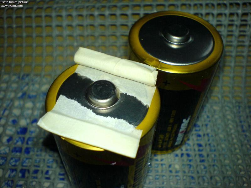

get some nice big fat batteries - the sort you need at christmas anyway
put some tape on top of one just to help ballance the other on it's top...
Now tape them together.

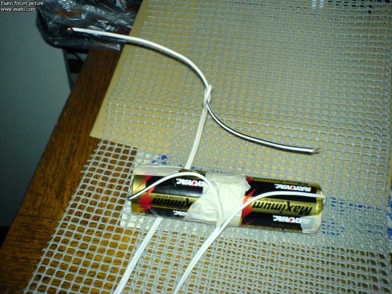

Speaker cable is ok for extending to the Crock Clips (RED/BLACK) - strip 2" off the end and roll it up so you get a good chunk to tape to the battery terminals.
Tie the loose end (as shown) so there's no chance of a short!
Crock the ends (Make sure "+" is attached to the RED Crock and "-" to the BLACK)
Before pluggin the cruiser cable in take the battery cover off the phone, it's easier to slightly remove battery and reinsert it then...
PS. I allways stick the white with black line to "+"
Good Luck
