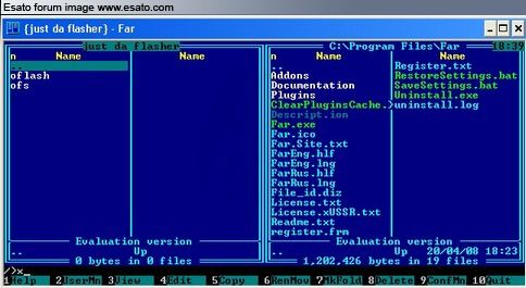

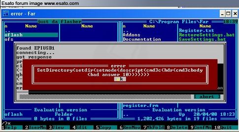

I think he was ironic yeah Xplode I made a mistake I'm soooo baaad now p
yes I'm trying to see with jdflasher but quite hard to use...
I've cliked on 'just da flasher' :
http://www.esato.com/board/img.php?id=102874
and then it recognized my phone and I get that:
http://www.esato.com/board/img.php?id=102875
and when I clik on ofs I get an error msg:
http://www.esato.com/board/img.php?id=102876
someone can help please, in order to replace my camdriver0.dat file? thx

nebraska,
Unfortunately, I have no manuals for JF in English but I don't think it'll be too difficult for u to use it. It's about just the same as SEFP but with extended capabilities.
No need to change drivers and so on. Just unpack it to FAR\Plugins and enjoy. And, there is an add-on for JF, about 15MB, which allows it to install patches, read FS, etc. This add-on is a must otherwise the JF itself (1.7MB) will remain just a toy.
I don't know exactly how it works with CID53 but in mine I first installed 'quick access' patch for db2020 via setool2lite, and then installed JF with add-on. Now when I need to extract or write files to the phone I should select 'db2020' in JF box, and to install/uninstall patches - 'qa2020' (feel the difference!).
I'm a noob in JF too but I've already experienced partial gfx replace on my 650 and was a success.

Posted: 2008-04-22 14:46
thank you much for your help Xplode
I finally succeed in replacind my camdriver, I had to install "JDflasher_53wrecovery" plugin, and everything was okay.
For the moment I don't need to flash or patch my phone, I just needed to have a better camera driver.
