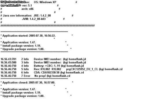

If he got one from cpw with r1j then it should av updated to r1l through seus and i got a k750i from cpw 3 days ago with r1l software already on it and i tried seus and got the same error as above it said operator not supported
does anybody know whats goin on here at all thanks
as you can see on this log the 7 at the bottom says error and for security reasons iv took imei number off

Wizardman
Joined: Jun 30, 2004
Posts: 18
From: North West England
Posted: 2005-07-31 00:09
any ideas about what iv posted please
my report i dragged from ...... C:\Program Files\Sony Ericsson\Update Service\log
thankyou to whoever can help me

@Wizardman
Look at my message there (CDA list):
http://www.esato.com/board/viewtopic.php?topic=95662&start=510
Change your CDA.

why would i want to change my cda and void my warranty also i updated a phone before with the same cda as the one iv got now unbranded so its nothing to do with that

http://www.se-world.info/thread.php?postid=149729#post149729
iv looked there and theres nothing wrong with my cda

Your CDA is correct, but you've asked why can't you update with SEUS. I said: change your CDA. If you want to update now, change, if you have time to wait: wait!
Sorry!
