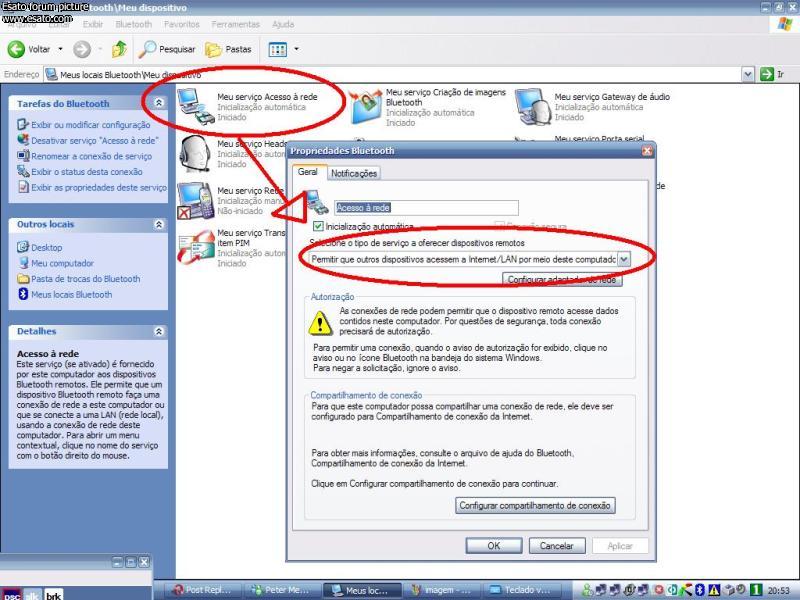

go to "My Bluetooth Places"
than -> "show my bluetooth services"
than ->
I know you may have it in english, but the position is the same
THERE is the place you have to share... by selecting the option "allow other devices to access internet/LAN thru this computer"
AND NOT at the "Network connection" place from windows...

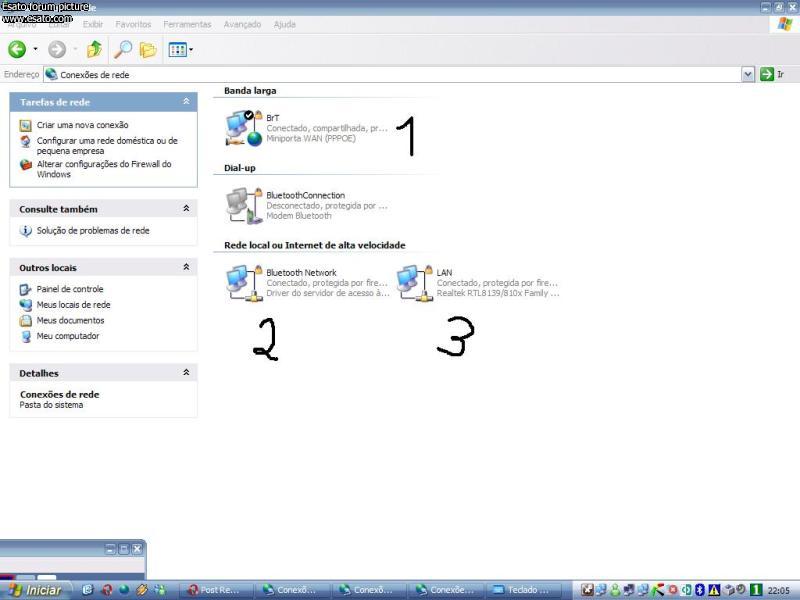

here
1 - My PPPoE ADSL connection
2 - the Bluetooth Network connection [created by widcomm install]
3 - My ethernet adapter connection [LAN]
So, at 2, you DON'T SHARE!!!
its here you share
After this, you have to share 1 with 2
your PPPoE with your BT network
or
Bridge LAN+PAN [this didn't worked for me.. had to share adsl with bt network]
