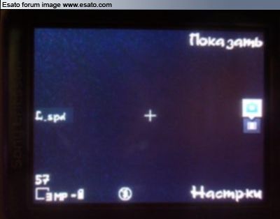

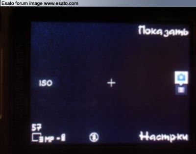

demion Joined: Jun 18, 2007 Posts: 2 PM |
this s my patch fo k790 r8bf003
Code:
;k790 R8BF003
;for raider camdriver v633
+44140000
018E278C: 122232002E00300000 630079002d00720064 ;'-2.0'->'cy-rd' (balance cyan - red)
018E2798: 122231002E00370000 790065002d0062006c ;'-1.7'->'ye-bl' (balance yellow - blue)
018E27A4: 122231002E00330000 6f0072002d006c0062 ;'-1.3'->'or-lb' (balance orange - light blue)
018E27B0: 122231002E00300000 200063007700620000 ;'-1.0'->'cwb' (Custom White Balance)
018E27BC: 122230002E00370000 63006f006e00740072 ;'-0.7'->'contr' (contrast)
018E27C8: 122230002E00330000 63006f006c006f0072 ;'-0.3'->'color' (colors saturation)
018E27D4: B10030002E00300000 66006f006300750073 ;'0.0'->'focus'
018E27E0: 2B0030002E00330000 200045005600000000 ;'0.3'->'EV' (EV compensation)
018E27EC: 2B0030002E00370000 46002e007300700064 ;'0.7'->'F.spd' (shutter speed fast)
018E27F8: 2B0031002E00300000 53002e007300700064 ;'1.0'->'S.spd' (shutter speed slow)
018E2804: 2B0031002E00330000 2000490053004f0000 ;'1.3'->'ISO'
018E2810: 2B0031002E00370000 7a006f006f006d0000 ;'1.7'->'zoom'
018E281C: 2B0032002E00300000 200041004500000000 ;'2.0'->'AE' (AE lock) |
and EV bar
download http://www.fileshost.com/en/file/55779/rider633-zip.html
[ This Message was edited by: demion on 2008-08-14 22:35 ] |
u can find png for EV bar in link i gave in previous post.
by the way. it is not a gfx pach. it changes '+0.3' to 'EV' , '+0.7' to 'F.spd' and so on |

jokamaciek Joined: Feb 28, 2008 Posts: 102 From: Poland PM |
demion U R genius I ported your patch to K800 RBF:
Code:
| ;K800i R8BF003
+44140000
01A79730: 122232002E00300000 630079002d00720064 ;'-2.0'->'cy-rd' (balance cyan - red)
01A7973C: 122231002E00370000 790065002d0062006c ;'-1.7'->'ye-bl' (balance yellow - blue)
01A79748: 122231002E00330000 6f0072002d006c0062 ;'-1.3'->'or-lb' (balance orange - light blue)
01A79754: 122231002E00300000 200063007700620000 ;'-1.0'->'cwb' (Custom White Balance)
01A79760: 122230002E00370000 63006f006e00740072 ;'-0.7'->'contr' (contrast)
01A7976C: 122230002E00330000 63006f006c006f0072 ;'-0.3'->'color' (colors saturation)
01A79778: B10030002E00300000 66006f006300750073 ;'0.0'->'focus'
01A79784: 2B0030002E00330000 200045005600000000 ;'0.3'->'EV' (EV compensation)
01A79790: 2B0030002E00370000 46002e007300700064 ;'0.7'->'F.spd' (shutter speed fast)
01A7979C: 2B0031002E00300000 53002e007300700064 ;'1.0'->'S.spd' (shutter speed slow)
01A797A8: 2B0031002E00330000 2000490053004f0000 ;'1.3'->'ISO'
01A797B4: 2B0031002E00370000 7a006f006f006d0000 ;'1.7'->'zoom'
01A797C0: 2B0032002E00300000 200041004500000000 ;'2.0'->'AE' (AE lock) |
