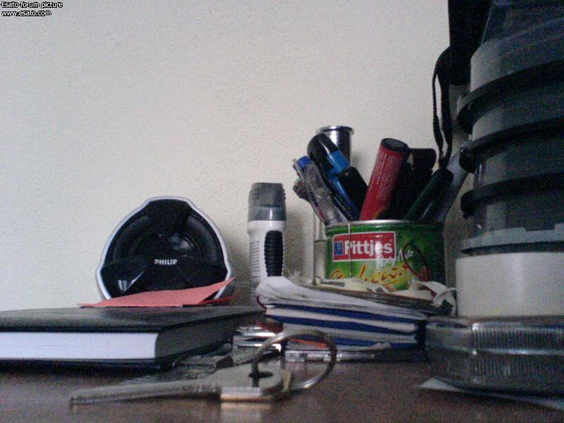

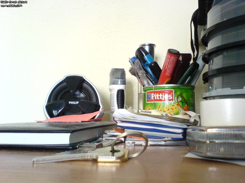

mariusee Joined: Apr 01, 2007 Posts: 29 PM |
@kopritis
excellent driver.... i like a lot
thanks for jpeg compression... is more stable now
.. and the ENM is fantastic !!!!!!!!!!!!
with ENM
with simple Night Mode
