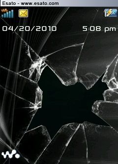

rcjp03
Joined: Apr 09, 2010
Posts: 50
From: Baguio City, Philippines
Posted: 2010-04-20 11:08
i cant get it to work >.<
can someone help me with this?
everytime I upload the white walkman icon. it wont work >.<
and everytime i upload the white walkman icon together with the menu.ml
this comes up
menu and contact icons are gone >.<
or can you give me a link on where to download
the orange walkman icon for left key, sony ericson logo in the center and file manager in the rightsoft key
Thanks in advance!
