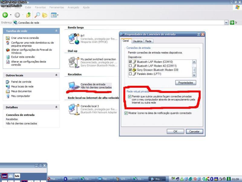

I'll post some print screen with my network conections
There is a conection called "Conexão de entrada" wich allows Virtual Private Network
In the devices allowed to connect I can choose the LAP [lan access point] modem, and a bluetooth modem
the LAP modem was created from Bluesoleil, the Bluetooth modem i installed from SE drivers.
Can I go trhu this?

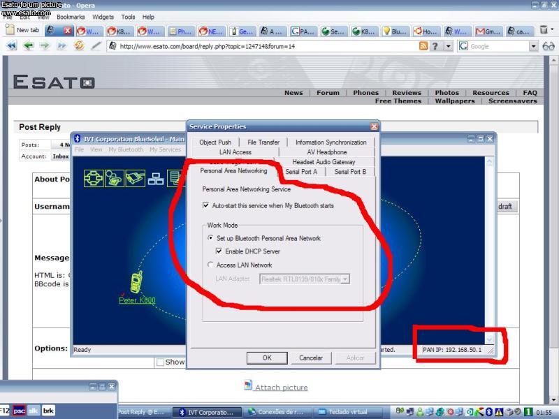

also, on my bluetooth software there's an option in PAN tab, the work mode, which one i choose?
And here are my conncetions
1 - My PPPoE to connect to the net
2 - My bluetooth PAN connection with the PAN Network Adapter
3 - My LAN connection, realtek ethernet adapter conected to my ADSL modem
My LAN is set to IP 192.168.0.1
My PAN to 192.168.50.1
I cant bridge, otherwise it drops the PPPoE
shall I share it?

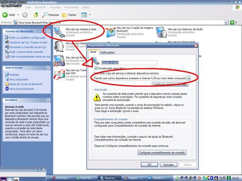

Its simple as said it was, when you start the PAN service on your bluetooth software , and than check under >>Data Communication >>Data Accounts >> ^^[your PC name]
So now i set the Internet Profile, and Java Profile, bridge LAN and PAN.... and

My bluetooth software has the option under
>> Work Mode to
-> Set up Bluetooth Personal Area Network with an option to Enable DHCP server
or
-> Access LAN Network with an option LAN Adapter : [Here appears my Enthernet Adapter connection]
*and when bridged LAN+PAN
[appears the bridge connection as selectable]
What do I select?
Set up the PAN with DHCP server or Access LAN thru Ethernet Adapter/or bridge and select here the bridged connection?
