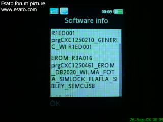

Well i plucked up enough Courage and reflashed my phone using wotan server.
I purchased 2 credits and did the erom first and then the rest of the phone.
I was total bricking my self sh*tless.
However it did work. As you can see from the pic. (The pic was taken from my other K800i that is waiting to be updated but one phone at a time).
Any way. Its all done now and i can go to sleep.
Any questions please ask, I will always try to help.
