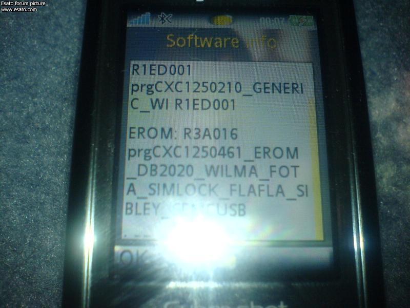

 EROM sort of means extended ROM. It contains the primary certificate of the phone. You can upgrade it from r3a011 to r3a016 using Wotanserver.
 If you do this though you will also need to flash the firmware (even if you allready have R1ED001), so you will need 2 wotan credits.
 IF YOU JUST UPGRADE THE EROM WITHOUT REFLASHING THE FIRMWARE YOU WILL HAVE A PHONE THAT WON'T SWITCH ON
 If you do this, this should in theory stop all the problems with the WSOD's and the phone not turning on again. Something i experienced myself.
 I have to say mine went perfectly.
 Picture attached. Please excuse the image it was taken on my other halfs W810I.
