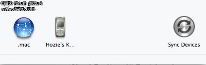

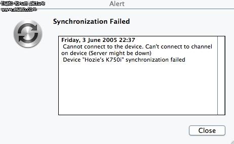

No luck with that method here Jools - followed instructions to the letter but I'm having some weird behavior - my K750i shows up with a K700i-ish icon in iSync (dunno if with your method it should use the correct icon) and the error I get is still as per below... any thoughts?

Also, whenever I got that channel error I had to restart the phone to get rid of it...

Hoziedude Joined: Mar 15, 2005 Posts: 6 PM |
Really strange - tried all of that... there are definitely permissions issues at work as Disk Utility corrects loads of them on the iSync files but whatever I do with the PhonesPlugin folder iSync doesn't seem to pick up the K750.tiff file correctly... Would you mind double-checking the folder you uploaded to make sure it contains everything it does on your comp? Thanks dude... |
In the meantime, I've reinstalled iSync from the Tiger install CD using pacifist - that cleared up my permissions issues. However, I still get the generic phone icon instead of the K750i one and still fail to sync my contacts or iCal...
Just to triple-check, I put the PhonePlugins folder inside ~/Library and NOT inside User/Library... Haven't touched any of the files, deleted pairing from phone and comp, etc etc... still no worky here...
I do have the K750.tiff file in that folder but iSync doesn't seem to pick it up for some strange reason - it just uses the generic one.
