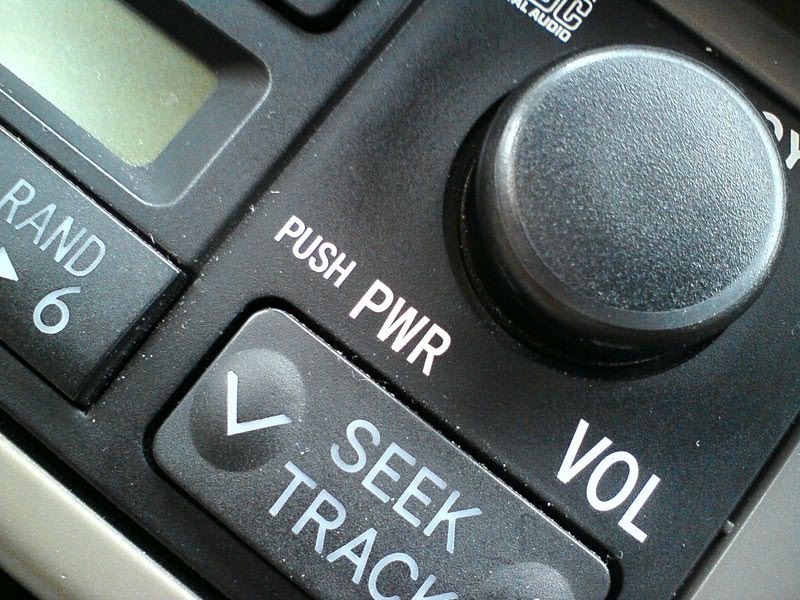

this is what N1 3.2 can do in twilight:
this one is just a macro snapshot.
Esato is NOT comfortable anymore for anyone to stand opinions! >> READ, AND THINK.
