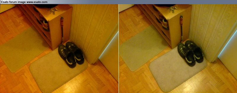

number1 you don't have to say nothing more. your age doesn't interest me. i don't want to stress you but all i can see that you are more 'superstar' than 'modder', if you don't agree then maybe you can explain something for us. your flagship theory is saying:
whitebalance on the k800i is awful, it adds yellow to compersate for blue sky etc, also the picture is slighty over exposured, the whitebalance is in the main but it can be turned off in the driver
i turned the whitebalance off in the driver
so, i uploaded your 2.99 to my phone and then on all auto settings i did small test. my conclusion:
1. you or me have f****d up camera
2. you don't know what are you talking about or i don't know
3. in worst case you or me have problems with eyes
left: just after camera open, right: some seconds later
as you can see your 'turned off' WB is working fine as typical auto WB
my last post about number1 unless i'll have to answer on his post

i fought you picked on me because i am alot younger than you maybe i am wrong???.
About the whitebalance no having the whitebalance off on indoor pics won't reallly make any difference it's outdoors in sunlight it makes a huge difference the sky will actually be a more natural shade of blue, the grass will green not a mix of yellow & green and the pictures won't be misty.

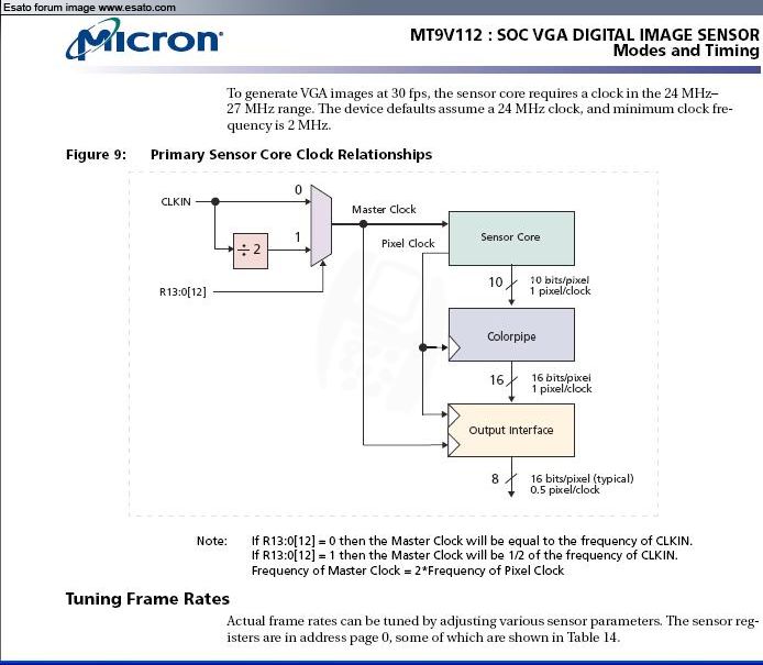

What does it mean to you overclock to mobile phone for u number1?
The model can work k800 with two schedules, one for chip high resolutions MCB881 Sony for the other Micron MT9V112 VGA resolutions that I think that everybody knows.But the key is the set-chip sensor-lens-hardware as I said many times, this system is the collection to all programming is answered by this collection.

overclock is to increase the MHZ, the front vga camera with the micron cam module runs 24MHZ by default look at the oringal 2.3 driver.
//Power on sequence
cam_power_on_2=5, 0, 0, 1, 0; // Set reset low
cam_power_on_0=5, 1, 26, 1, 0; // Set GPIO26 (CAMDIR)as output
cam_power_on_1=5, 2, 26, 0, 0; // Set GPIO26 (CAMDIR) as low (open bus to VGA camera)
cam_power_on_3=5, 1, 35, 1, 0; // Set GPIO35 (CAM27_EN) output
cam_power_on_4=5, 2, 35, 1, 0; // Set GPIO35 (CAM27_EN) as high (2.7 V on)
cam_power_on_5=5, 3, 4, 5dc0, 64; // Enable 24 MHz APLL clock wait 100 ms
cam_power_on_6=5, 0, 0, 0, 5; // Set reset high; wait for 5 ms
//Power off sequence
cam_power_off_0=5, 3, 4, 1, 0; // Disable clock and set low
cam_power_off_1=5, 0, 0, 1, 0; // Set reset low
cam_power_off_2=5, 1, 35, 1, 0; // Set GPIO35 (CAM27_EN) as output
cam_power_off_3=5, 2, 35, 0, 0; // Set GPIO35 (CAM27_EN) as low (2.7 V Off)
cam_power_off_4=5, 1, 26, 1, 0; // Set GPIO26 (CAMDIR) as output
cam_power_off_5=5, 2, 26, 1, 5; // Set GPIO26 (CAMDIR) as high (close bus to VGA camera); wait for 5 ms
cam_i2c_address=5d;
cam_vf_clock_freq=4, 5dc0; 24MHZ
cam_ss_clock_freq=4, 5dc0; 24MHZ
cam_init_result=;
cam_ss_format=B100;
cam_vf_format=B100;
could the MHZ be increased further or is 24MHZ the limit?????

Posted: 2008-02-29 20:11
[quote]
cam_vf_clock_freq=[4], 5dc0; 24MHZ=>*div Table Block Diagram
cam_ss_clock_freq=[4], 5dc0; 24MHZ=>*div Table Block Diagram
*Divided the frequency
cam_init_result=;
cam_ss_format=B100;
cam_vf_format=B100;
@Number1
Do you read the comments, information or posts from other modders?
I donīt think so
For mobile phones overclock is not only increase the frequency, but by the hardware at risk to changes in voltage and other things
Not number1 the limit to work with 30fps recording of video in a camera of sony with these sensors is 27mhz this to these models of chip-sensor.Have models that support up to 48mhz in the two frequencies synchronized as the model k510.
Each model has its master clock
Micron-MT9... series
sensor block
You can sustain its ideas number1 but not everyone agrees with his view
Again everyone is to help, not to prove anything to nobody number1
Continue with your work and good job!

why should i pay attention on comparision between 2 cameras with different sensors each from other vendor? once again you used "whitebalance off" - do you want more pictures from 2.99 which show you that auto WB is working fine and it's not off?
code: set WB value 0x80 for auto
interpreter: let it be
camera: what the hell?! 0x80? i don't know this! i will use auto mode instead
ok, maybe small explanation. i'm software engineer, testing procedures are huge part of my work. there are no 'slightly', 'probably', 'maybe' - everything must be checked, verified and explained
