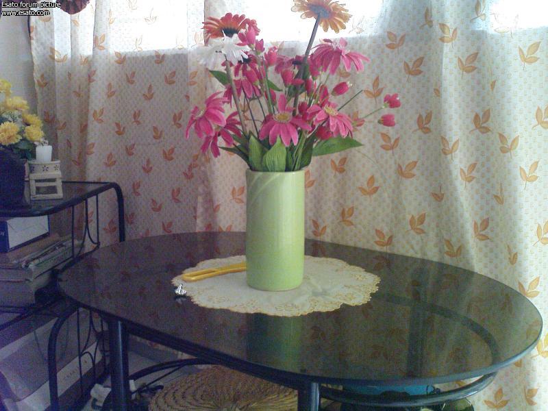

 | the p1 of my cousin has a violet/purple and a green tint problem.,look at this one
   you can always find one if you know where to look i    myself |
| cell1st Joined: Nov 04, 2007
 Posts: 15
 If the curtain is supposed to be evenly coloured (the white areas), the picture is really terrible.
