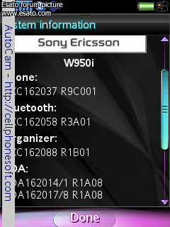

Ok to keep you up to date i have just sucessfully changed the cda on my w950i, i have the two lines as i did on the p990, but before i do seus can someone confirm the cda for generic w950i!

Thats the right CDA buddy.

Nanu
Sony CMD MZ5
Joined: Feb 18, 2006
From: Warrington, UK
Posted: 2007-02-20 18:34
Heres a screen shot!
