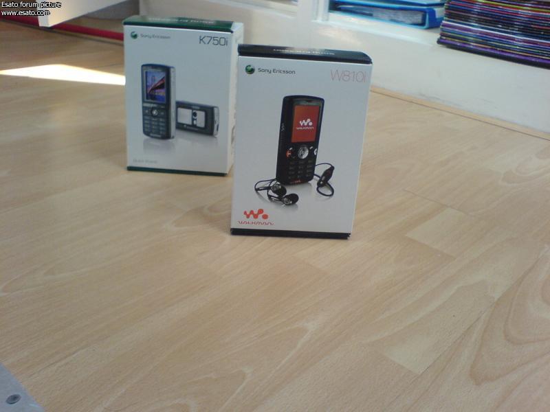

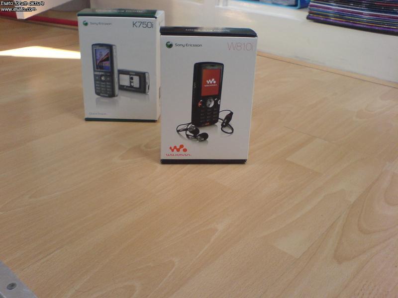

I have made also so compare picture of the w810i versus K750i. It is the same quality but the w810i has beter colors. I have made the pictures at the same time and on the same place.
Taken with the K750i:
Taken with the W810i:

Use night mood. The image is much better. Video recording is much worse than the k750i. Very bad in terms of camera and video. BUT the colours of this phone are much better  |
