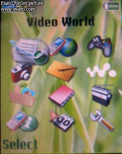

Okay. I have a question/problem.
I have removed the SE links from all the video, sound, theme folders according to the instructions given in this thread briefly described here: remove all the files/folders in custmenu then, the respective .itm files in custom folder. Now, the SE links disappear.
BUT at the same time, the PLAYNOW menu icon in the main menu has changed to another sony ericsson icon (not seen anywhere before) and it had a label "Sony Ericsson" first. I guess it's just a link to SE. But peculiar thing is that after I have loaded the data comm. and internet settings to the phone, the icon's label changed to "Video World". I have no idea what that means. I dont' want to try because it seems to take me to somewhere via internet and I haven't subscribed to any data plan and I don't want to pay for any per byte fees just to see what that "Video World" leads me to.
So, it seems that I removed the SE links and then created another yet annoying and useless menu icon.
My question is: (i) any way to get back the PlayNow icon and link (the same useless but at least it doesn't look as stupid as having a "Video World" menu on a cell phone.
(ii) any way to change that useless menu icon to something useful such as say "multimedia files", "memory stick drive" or "opera mini" etc?
Any pointers/advice will be very much appreciated. I am tempted to revert back to the SE links thing....
Below is the screenshot of that "Video World" icon (top left hand one, originally PlayNow button). Note I did NOT touch the menu.ml or the main menu. And I have NO access to internet. It's in the phone already when I removed the SE links.
Edit: Okay. I found out how to retrieve that useless PlayNow icon and link. I put the Content_hook folder and the relevant .itm file back to the original place and it's back there.

Update: I successfully changed the useless PlayNow button to something more "useful". I have wanted to link the icon to my Pictures folder but I couldn't get the correct link name after several attempts. So, I link it to my Applications. At least, better than PlayNow, imo.
It seems that what we see from FAR about the internal file system is not all in the phone. I still find something missing. E.g. I cannot locate the link source "internal" in menu.ml. Maybe some have already been compiled and not in "code" language or it's hardcoded in the hardware? Sorry for my naivete. I am not a programmer of any sort. This is just my wild guess.
Here is the screenshot of my replaced "PlayNow" icon linking to Applications (top lefthand one) in the main menu. Yeah, I changed some of the menu icons to iCandy Junior ones .
