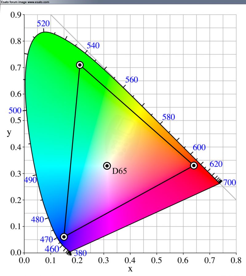

COLORS
Table Colors Correction for this models K850/C902/C905/W902/W995
#SET_REG(65,xx)
#SET_REG(66,yy)
#COM_EVENT(13,zz)
zz = color correction 00 = disable, 01 = enable
xx = 00 - 7F = cyan, 80 - FF = red
yy = 00 - 7F = yellow, 80 - FF = magenta

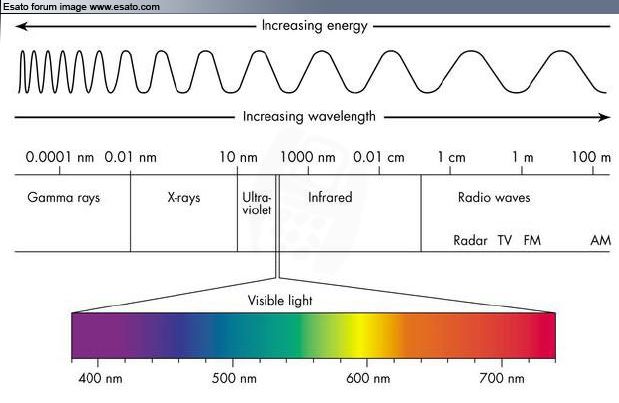

[b]The colors of the visible light spectrum

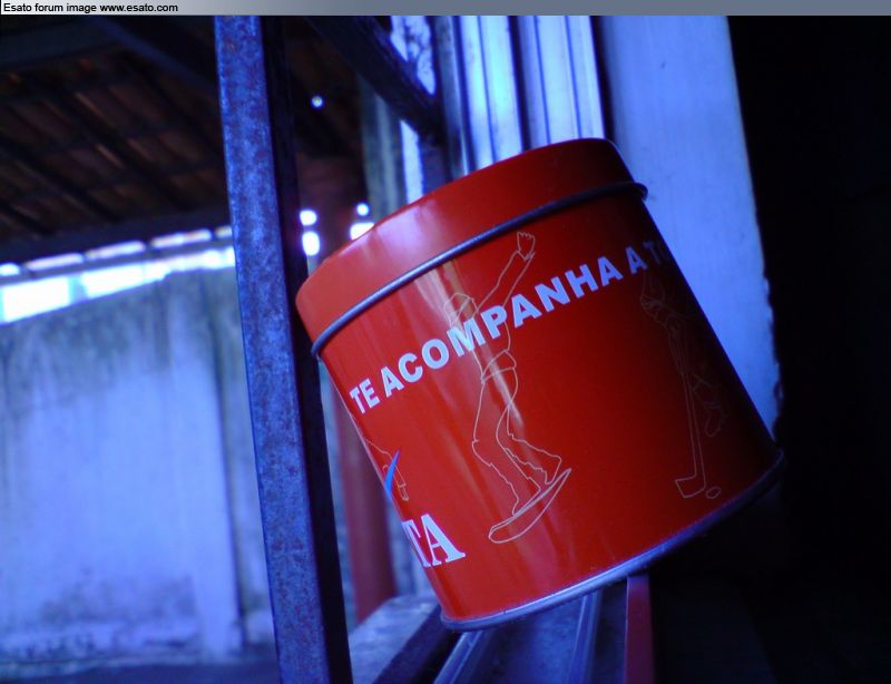

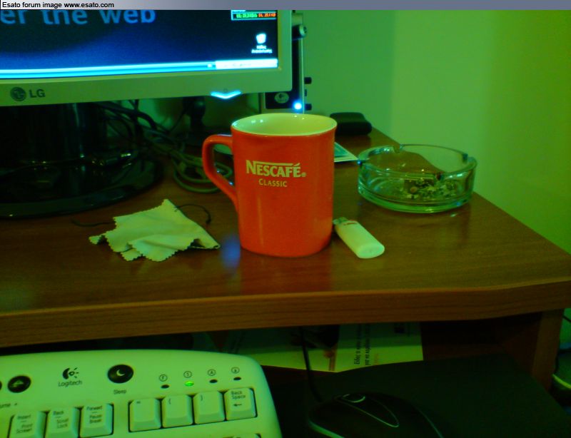

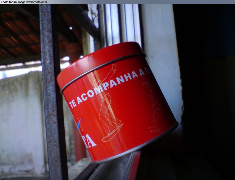

Luhccas-U1a
Satio Black
Joined: Mar 24, 2008
Posted: 2008-12-02 10:39
Testing...
Red on incandescent are near of real
Sample incandescent WB:
Sample Fluorescent WB:
