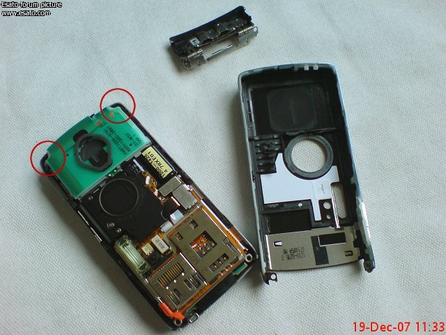

I have the very creaky back and mine sounds like there is something loose rattling around inside when you gently shake it even though its never been dropped.
I had this so I opened mine up today. Found that there are two capacitors for the flash, which are not fixed down. I put a bit of masking tape in there, folded it up to pad it out a bit and no more rattle.

@martuk: So if I wan't to eliminate rattling it I need to open it up?
Oh why did they made it bad like this...
Can someone post a photo how it looks like inside?
There is a bit of moulding on the rear cover which is supposed to keep it tight but in my case does not. Here is a pic. Ignore the red circles, the bit you need to worry about is the black parts below the camera with the yellow label on.

Thanks, martuk.. I'll check it out.. Pretty annoying...
