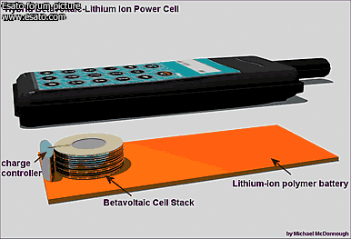

Cellphones powered by nuclear power could be not too many years away following developments by scientists at the University of Rochester. The details of the technology which uses radioactive gasses, already licensed to BetaBatt, appears in this month's issue of Advanced Materials.
Betavoltaics, the method that the new battery uses, has been around for half a century, but its usefulness was limited due to its low energy yields. Similar to the way solar panels work by catching photons from the sun and turning them into current, the science of betavoltaics uses silicon to capture electrons emitted from a radioactive gas, such as tritium, to form a current.
The new battery technology makes its successful gains by dramatically increasing the surface area where the current is produced. Instead of attempting to invent new, more reactive materials, Fauchet's team focused on turning the regular material's flat surface into a three-dimensional one.
Part of the problem is that as particles in the tritium gas decay, half of them shoot out in a direction that misses the silicon altogether. It's analogous to the sun's rays pouring down onto the ground, but most of the rays are emitted from the sun in every direction other than at the Earth. Fauchet decided that to catch more of the radioactive decay, it would be best not to use a flat collecting surface of silicon, but one with deep pits.
A layer of silicon riddled with pits, each of which would fill with the radioactive tritium gas, would be like dropping the sun into a deep well lined with solar panels. Almost all of the sun's rays, no matter which way they were emitted, would strike a well wall. Only those rays that fired straight up and out of the well would be lost. With this reasoning, Fauchet devised a method to excavate pits into a microscopic piece of silicon.
The pits, or wells, are only about a micron wide (about four ten-thousandths of an inch), but are more than 40 microns deep. After the wells are "dug" with an etching technique, their insides are coated with a material to form a p-n junction just a tenth of a micron thick, which is the best thickness to induce a current. The Advanced Materials paper details how these wells were dug in a random fashion, yielding a 10-fold increase in current over the conventional design. The team is already working on a technique to create and line the wells in a much more uniform, lattice formation that should increase the energy produced by as much as 160-fold over current technology.
"Our ultimate design has roughly 160 times the surface area of the conventional, flat design," says Fauchet. "We expect to be able to get an efficiency that very nearly matches, and we're doing this using standard semiconductor industry fabrication techniques." www.americanantigravity.com
