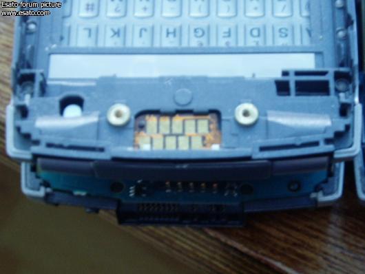

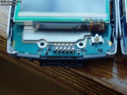

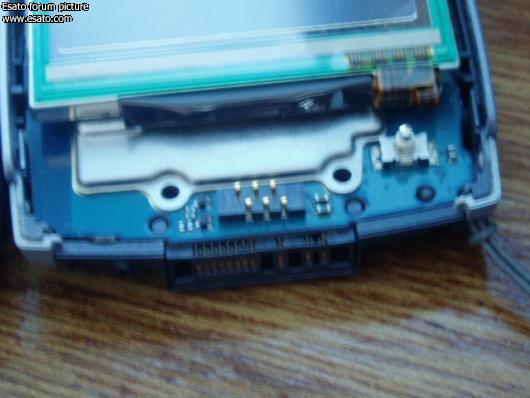

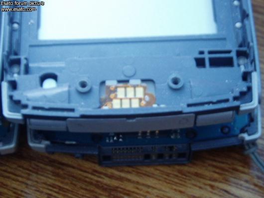

Posted: 2005-02-03 16:11
Update!
As many of you were asking, i decided to test the P910 flip on a P900 phone.
It did not work. Even though the phone was responding to the keys being pressed, it was not doing the desired action.
For example, pressing a number would bring up my Contacts.
I didn't bother trying the P900 flip on a P910 because
A) It's pointless
and B) If the P910 flip doesn't work in the P900, then it's not going to work the other way around either
Here are some pictures of the internal pins of both phones.
P900 Pins
P910 Pins
P900 Flip Contacts
P910 Flip Contacts
Hope this puts your mind to rest.
-djkizlive
