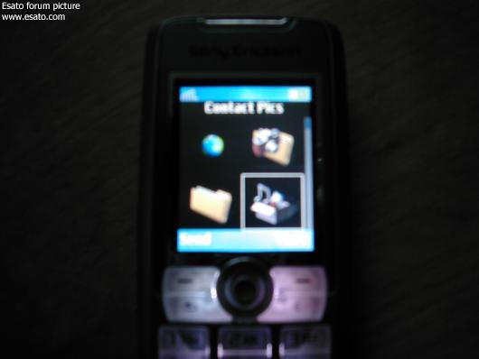

I used the Update Service to check for updates to my K700i but it just downloaded R2L again and now when I go to my pictures on the phone I had a folder in there called Contact Pics were I store all the pics I use on my phonebook contacts. This has now changed into an icon of a box with a musical note and a picture of a face in it and when I try to delete it I get "Cannot delete item, protected file". The only option I have is Send. The item is 0 bytes in size too!
The strange thing is that my contacts still have the pics associated with them even though it is not recognised as a folder!
Another side effect is that browsing through images (especially camera) are really slow to load, I can be looking at a black screen for 5 seconds before any images appear!
Anyone else had this problem?
p.s. I have enclosed a pic of the icon.

SEUS DOES cause various issues on phones.
After the first time I used it, I got my phone messed up. Other than loosing two frames in the camera, I've also had a corrupted Sony Ericsson.gif which was absolutely undeletable. All sub-folders in the Pictures folder disappeared while the pictures in them still existed. A Master Reset -> Reset All couldn't help at all. Finally, a 13 sec. trick uncovered the Camera folder but corrupted Sony Ericsson.gif still existed and lost frames have forever gone...

really strange. do a master reset, 13 sec... etc... but i doubt if it solves your problems.

simple, restart your phone. i had the sthing quite similar. my themes dissapeared even waip which i couldnt delete before. i tried putting it back on and it renamed itself to waip(1), meaning waip was still there only i couldnt see it. a simple restart solved it
