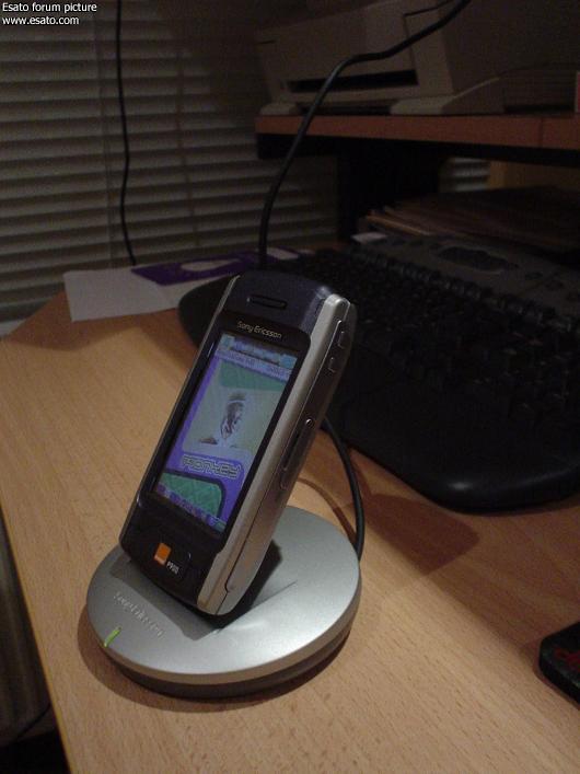

The thing that's bugged my since the doe eyed P900 flashed it's eye lashes at me is the need for a charger on the cradle. So tonight I decided it's time to 'get it's clothes off'! The most time consuming part of the whole exercise was finding my mutlimeter (to find 5V on USB bus) and then finding a 9V battery for my mutlimeter.
You need:
Small Phillip screw driver
Soldering iron with solder
Wire (Take the side off your PC there loads of unused wire for powering LEDs, speaker etc)

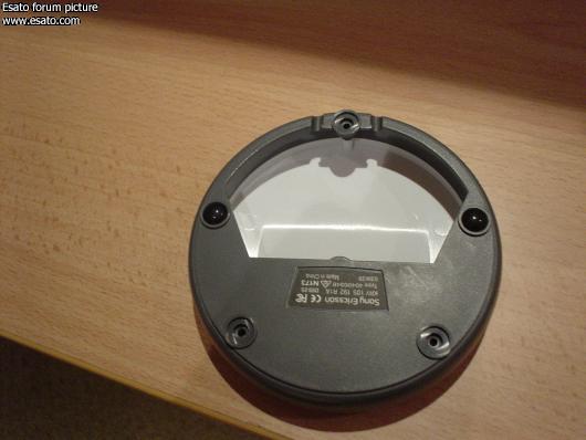

Remove the base (screws under 3 of the 5 plastice feet)

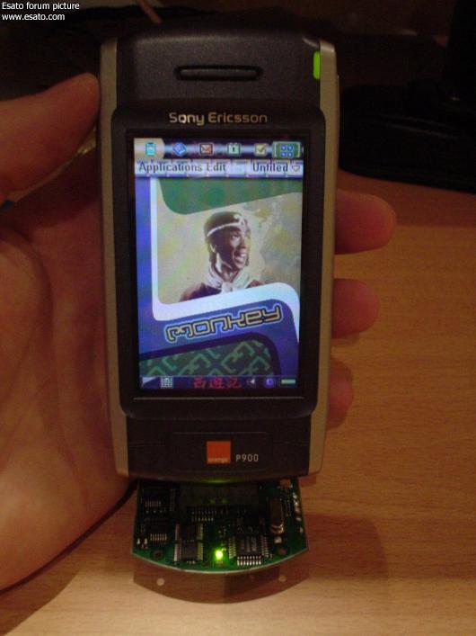

Remove the circuit board and solder a wire from the Red USB wire to the closest post of the mains input.
Job done
Mr Mince

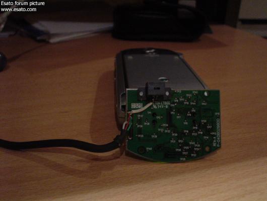

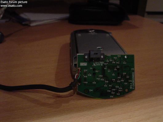

I soldered the white wire!! It's as simple as that, as it had to be, hence bugged so much.
switchbitch Joined: Apr 29, 2003 Posts: > 500 From: ELF Pap Cop (Avatar pending) PM, WWW
what white wire have you soldered and why??
mince-inside Joined: May 09, 2004 Posts: 452 From: Made in Alnwick living in Scot PM |
Shite man, I thought I was doing well, I guess a before and after would have been more correct, any how, I'll edited in photoshop a before (thanks for the compliment on my soldering if you cannot tell! )

A before (just for @switchbitch)
