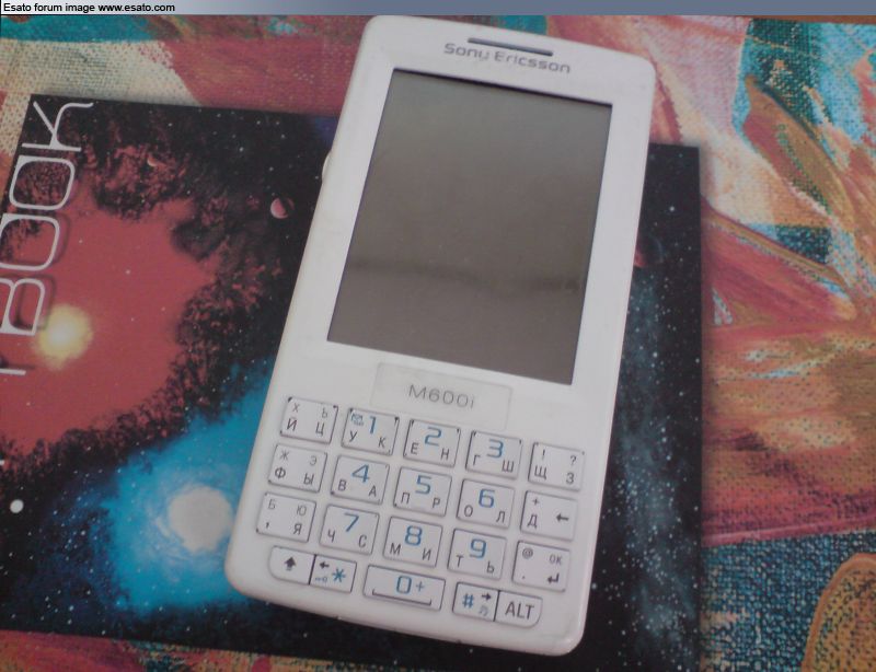

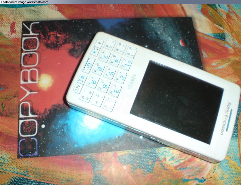

here is some photos:
can you realize some more sharpness?)

Thank u for testing the driver, but I do not think your photos represent the best of the driver's abilities...
ISO 100 for the close shots would not have made the the mouse picture overexposed with flash.
But thank u for trying my driver, friend
