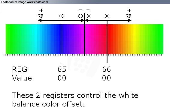

and a little tip for the WB_CC:
use the color table above to adjust the WB_CC...
for example: you see that your RED's are pink in the photo... then you should point the white balance to yellow so that the pinks go on the red and so on about any other color.

if you are experiencing too much yellow... then decrease it within the driver. |

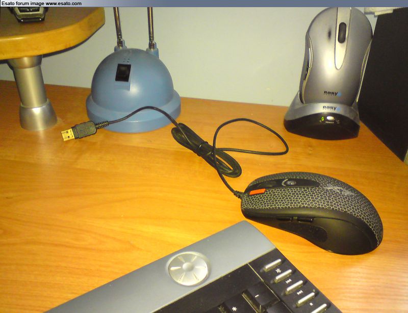

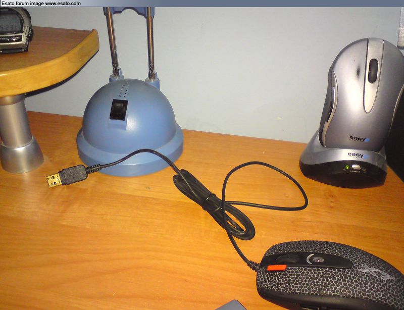

Samples:
Your settings:
WB_CC_MAGENTA_YELLOW 00:
chombos1 Joined: Jun 06, 2007 Posts: > 500 From: IRAN. PM |

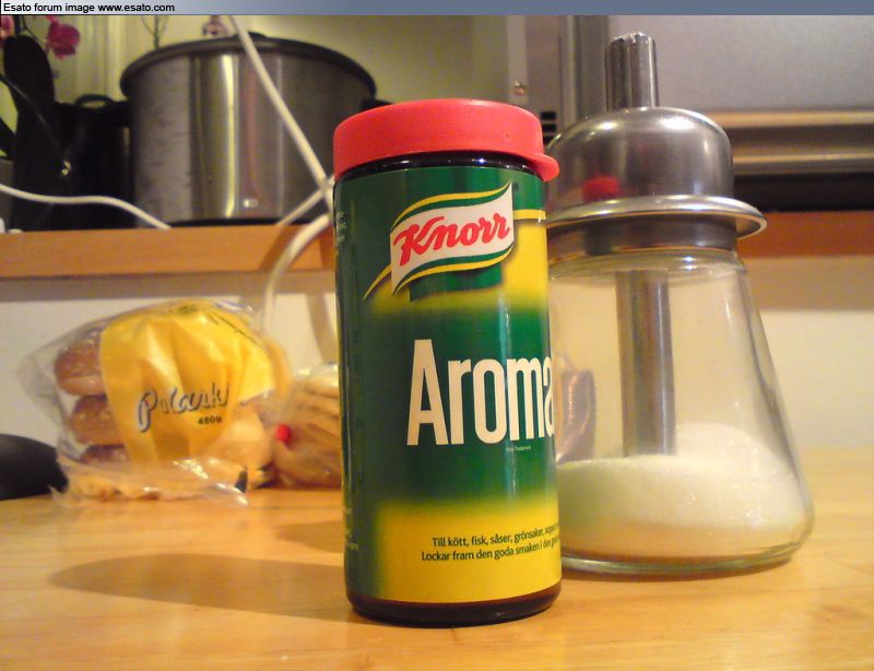

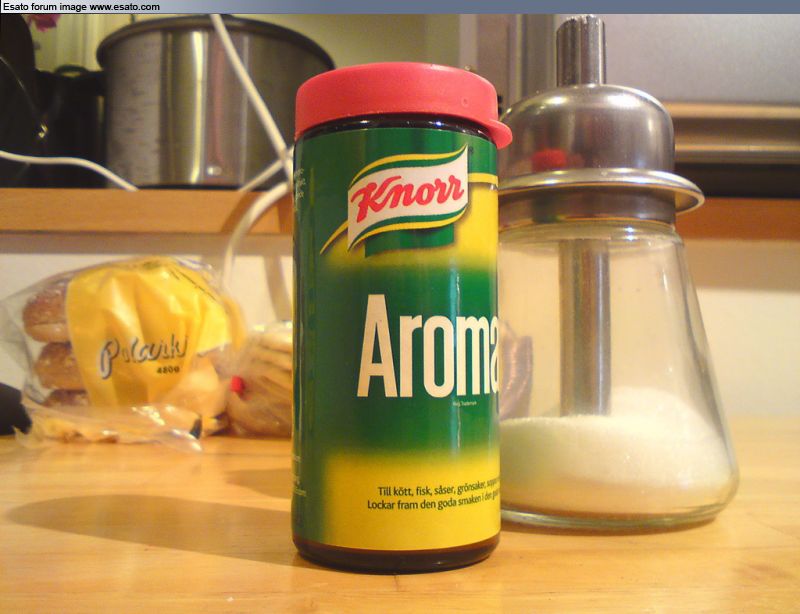

Ok, here are two shots of the same thing.
WB_CC_CYAN_MAGENTA=F7, WB_CC_MAGENTA_YELLOW=00:
and WB_CC_CYAN_MAGENTA=FA (like sugested), WB_CC_MAGENTA_YELLOW=00:
I think I'll stick with WB_CC_CYAN_MAGENTA=F7, since it seems the pictures are slightly darker but richer in colours. FYI: The "Knorr" logotype is really red, the lid of it is a little paler. |
