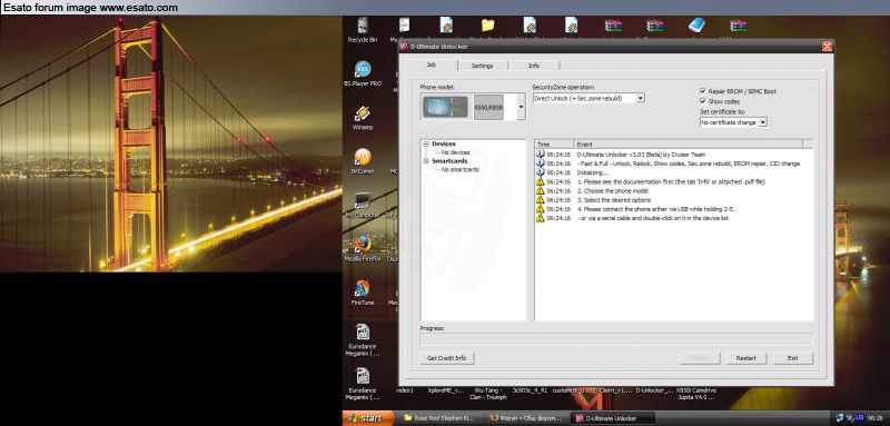

I think you can use D-Ultimate unlocker to repair EROM , i used it to change my certificate colour from brown to red for free . use v3.3 beta .
