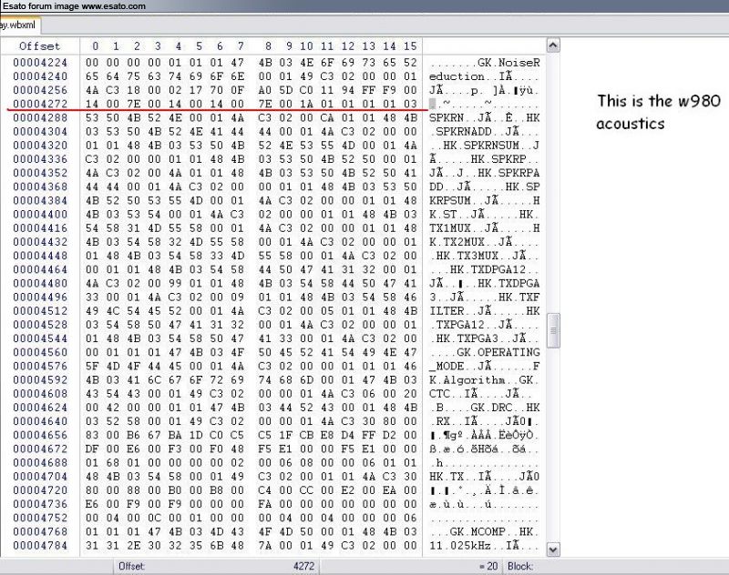

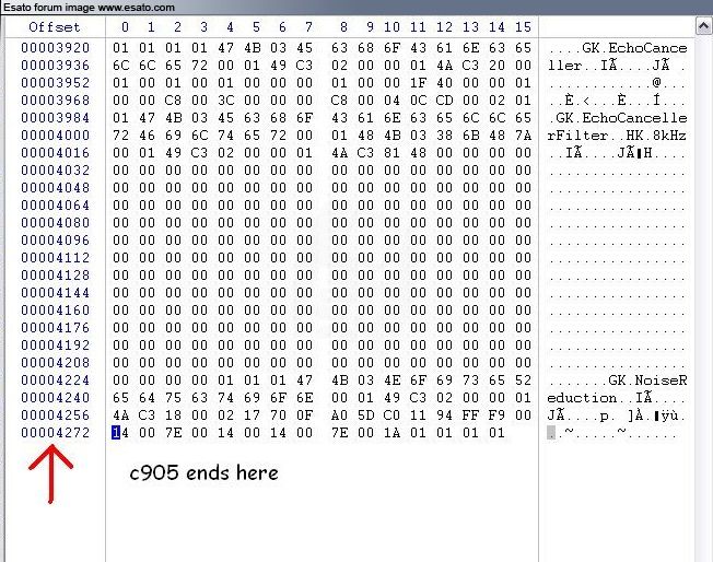

Luhccas-U1a Joined: Mar 24, 2008 Posts: > 500 PM, WWW
Well... w980 acoustics have some more offsets.I don't no how c905 will react with it.
Example:
c905 acoustic
w980 acoustic
I can use the values from w980 but just from 00000000 to 00004272,if you want i can make it  |
