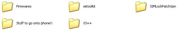

3. Rename your 2 files to something easy to remember (ie. main.mbn and fs.fbn)
Then make a few folders (as below) to make everything easy to do after)

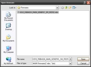

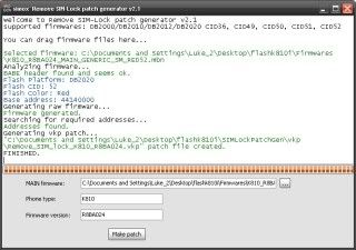

3. Open up SimLockPatchGen from "downloaded_archive>SIMLockPatchGen>SIMLockPatchGen.exe", and click on the file browser at the bottom, and find your file
Click make patch and this happens
then in the SimLockPatchGen folder there will be a folder called "VKP", and there should be a patch in there. Put that in the "Stuff to go onto phone" folder and rename it to "Unlock"

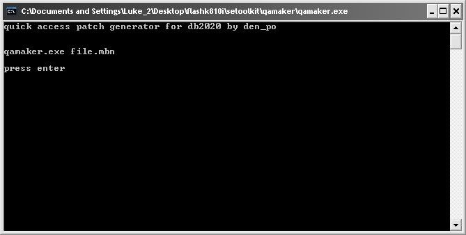

4. Go onto folder "downloaded_archive>setoolkit>qamaker.exe" and this will open
Follow the instructions in the program and then get the patch made and also put that in the "Stuff to go onto phone2 folder.

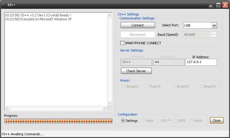

5. Now run XS++ from "downloaded_archive>XS++>XS++.exe".
This will open
MAKE SURE IT SAYS CRYSTAL IN BRACKETS SIMILAR TO BELOW
IF NOT DON'T USE THAT PROGRAM, IT WILL BRICK YOUR PHONE

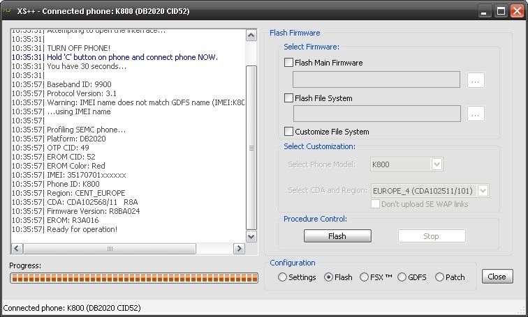

So when that is open you remove from phone the battery, sim card and Memory card just in case
Then put battery back in, and click the "Connect" button
Hold the "C" (delete) button on your phone, and put in your USB cable included with the phone (DCU-60). Once it is connected you will see something similar to this
6. BACKUP GDFS. Go to GDFS button at bottom and then click BACKUP GDFS and save it somewhere obvious just in case

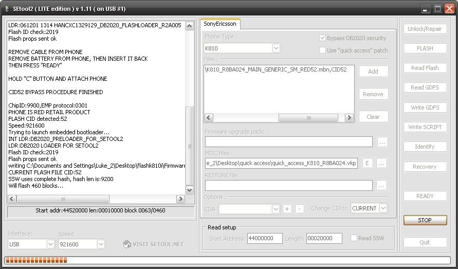

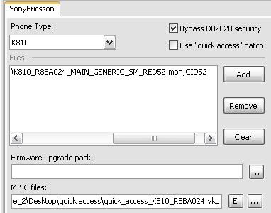

Open up setool2lt.exe from the setoolkit folder. Select your phone, TICK DB2020 SECURITY and click on the "Add" button add your MAIN ONLY
IN MISC ADD YOUR QUICK ACCESS PATCH by clicking the 3 dots ...
Click Flash (RIGHT HAND SIDE) and hold "C" button on phone and insert USB cable (DCU-60)
Then it bypasses security

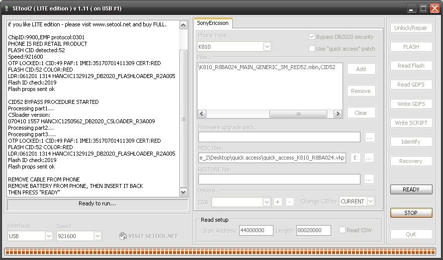

Part 1 (quite quick)
Part 2 (imbertween speed)
Part 3 (1 second) but then a long bit (5 minutes long ).
When that bit is eventually over you have to remove usb, then battery, click ready, hold "C" and last waiting now
Last waiting now
When you get a popup asking if you want to apply patch CLICK NO or else you will have to start again from this post not start all over again.

Open up setool2lt.exe from the setoolkit folder. Select your phone, TICK DB2020 SECURITY and in the firmware box add your MAIN ONLY
noo add the firmware in the files box I put it in the firmware box once and it corrupted the main

Boysie Joined: Jan 17, 2008 Posts: > 500 From: Southampton, England PM |
U cant open QAMaker.exe u drag ur firmware .mbn file onto it. Apply that patch the same way as qapatch using the guide above.
