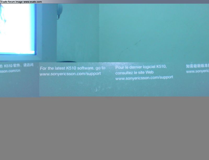

i am having trouble with my k800i when i take pictures some of the pictures get scrambled and mixed with other pictures taken previously and here is the wierd part, the new pic gets mixed with an old pic and the old pic is not even in the memory i had deleted it earlier its happening really frequently !!!
and its annoying !!
i have attached a sample !!
i have formatted the mem card many times !!

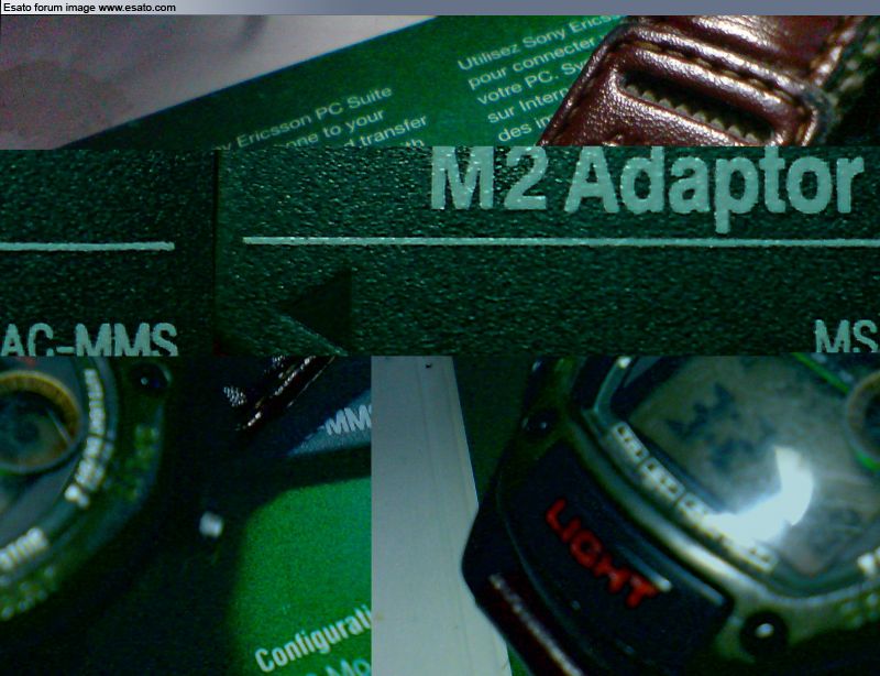

oh here is another one the green strip u see is a part of a picture i took a day ago and it got mixed with this pic i took just now !!!!
what the @!!#!@#!@#$@ !!

On the 2nd picture you posted, it is obvious that the jpg file is corrupted (look at the gray area).
It probably means that the phone couldn't write to that location.
Same goes for the 2nd picture that appears: When you delete a file, you don't physically delete it. The phone marks the space that the file occupied as "ok to overwrite". The phone probably couldn't overwrite the previous picture. However, your computer did manage to read (a part of) the previous picture, and that's why you see two pictures. The gray area is the area that couldn't be read. |
