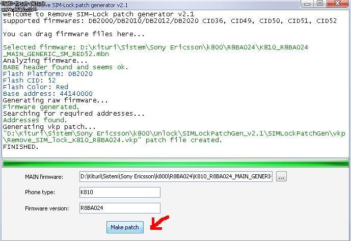

STEP1: SimLockPatchGen 2.1(Creating patch)
Open SimLockpatchgen.exe and select the main firmware(I used K810_R8BA024_MAIN_GENERIC_SM_RED52.mbn). It should detect automatically the model and the firmware version. Click "Make patch" and look for a .vkp file in the "VKP" folder.

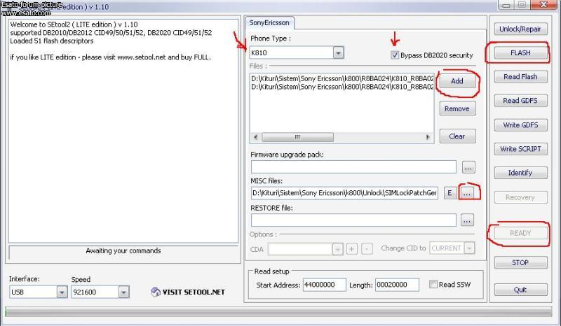

STEP2: Setool2lite
Open setool2lite.exe, choose phone type and check "Bypass DB2020 security". In the big rectangle from the right side "ADD" the MAIN(the same MAIN from STEP1) and the corresponding FS.
Lower, in the "MISC files", click on "..." and add the .vkp file generated at STEP1.
If you want to keep all that you have in the phone, flash ONLY MAIN !
Click "FLASH", connect the phone (swiched off and without SIM) holding "C" and the process begins. At a certain moment you'll be notified to unplug the USB cable and battery:
-unplug first USB cable then remove battery
-put battery back in, click "READY" and reconnect the phone holding "C"
When a dialogue about script file will pop-up(YES/NO), select "NO"!
After few minutes the process ends and you can unplug the DCU cable.

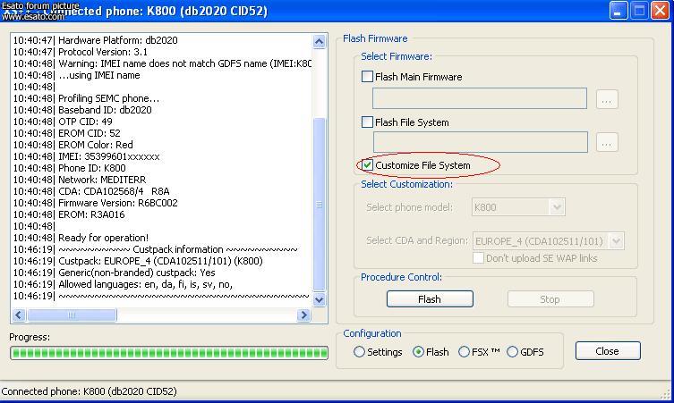

1.Click "CONNECT" (with the phone turned off) and plug in the DCU cable holding "C". You should see at the left side informations about your IMEI, firmware, CID, etc.
2. Check "Customize File System"

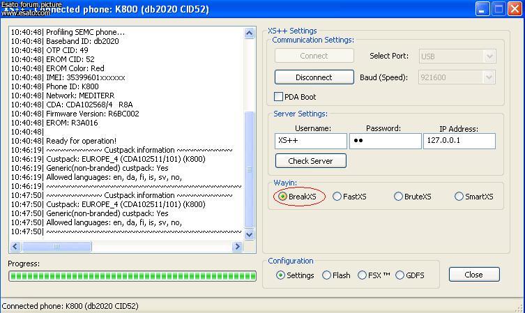

3. In the "Configuration" rectangle in the right lower corner, choose "Settings", then check "Break XS"
4. Select "FSX", then "StartFSX"
Watch the progress bar;after 1-2min you should see:
"++ Customizing was SUCCESSFUL!
++ Disconnecting phone...
++ You may now unplug your phone.
++ FSX was successful"
