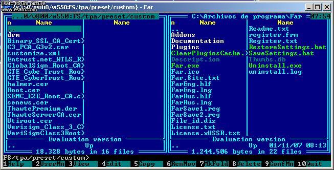

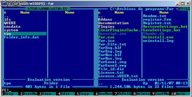

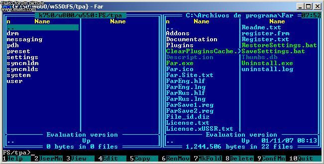

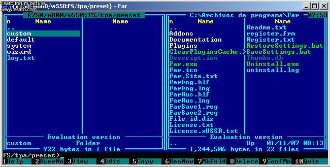

Posted: 2007-08-09 13:57
if you want to finalize your phone you need to copy the certificates into FS/tpa/preset/custom
FS
tpa
preset
custom
