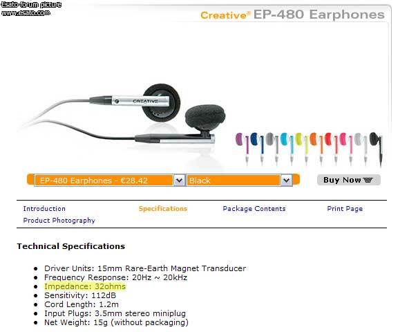

So if you want loud earphones get Shure e4c and e5c and from the cheaper side the Creative EP-480 which are unbelievable loud. The volume gets twice as high compared with the SE HBHDS970.

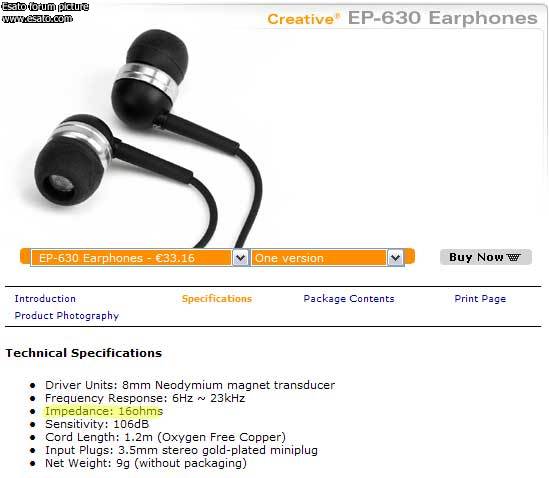

I've bought Creative EP-630 headphones, they sound excellent and are bit louder than stock ones.

EP-630 have 16ohms impedance..if you try earphones with 32ohms you'll be the happiest man in the world..Try EP-480..you can find them from 5 to 15 euros in ebay..
