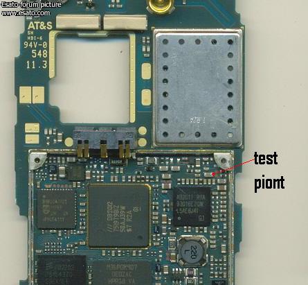

After using SemcTool 8.4 to debrand my K750i CID49 (flashed both FS and Main), I could complete the phone for free using Setool Cracked v91373. (there a bug in semc 8.4 that complete fs does not work)
In option tab of Setool choose use TP and complete phone, then choose K750i model and press flash, it will ask you to remove and connect TP several times:

feco Joined: Jul 03, 2004 Posts: 245 PM |
I used SEMC 8.4 Cracked and Setool cracked with service cables |
If you ever flash ur FS area and u want to complete it for free you have to use testpoints to complete it... follow the steps in the first post to complete ur phone
tosinv Joined: Aug 02, 2006 Posts: 216 From: India PM |
Do we have to open the phone and do it is there no way we can finalize the phone without the test point without paying |
