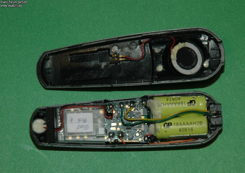

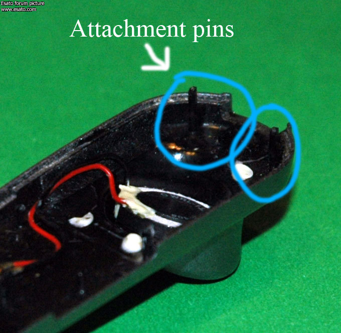

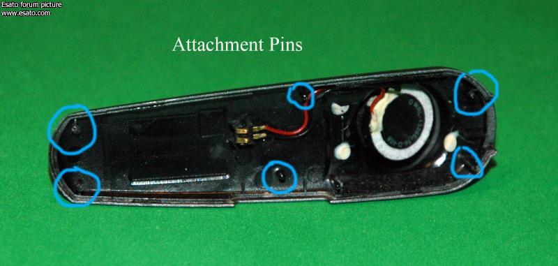

I cannot properly upload images, here are some of the dissasembled device. I will finish the post later. got meetings today.

mathios
X2 White
Joined: Feb 24, 2004
From: greece
Posted: 2006-10-10 00:15
great job thanks! [addsig]
