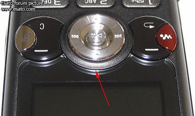

Got mine about two weeks ago. Was VERY squeaky and creaky. It has gotten better by quite a bit. On mine it is coming from between the black plastic frame around the nav-pad and the plastic lcd cover. Wish the build quality was better but it's still my favorate SE so far out of, t68-t610-k700-k750.

Hi, I had the same problem with my w810. Posted the problem on a Norwegian forum and someone advised me to use dielectric silikon paste, the kind they use to grase mekanisms inside for example DVDplayers. It doesn't melt with heat and it doesn't conduct electrisity, so it isn't harmful to electronics. Just put som on the d-pad and use it a little, then wipe off the excess paste. Now my new phone is silent like it should be. |

lars: do you put it on the navi-pad itself, or did you have to open it up? |
larsstea Joined: Apr 26, 2006 Posts: 4 From: Norway PM |
@axilom: I put it around the edge of the d-pad, without taking anything apart. While applying the paste I tried to push down on one side while applying to the other side, so that the paste would get in between the pad and the cover. |
