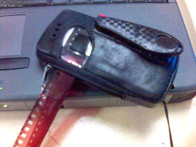

It's quite simple really. You could buy an IR pass filter, or simply use the black section at the start of an exposed roll of film. Fix it to the front of the camera such that it fully covers the lense and blocks any visible light from entering the lense. This black strip is invisible to IR light, yet blocks visible light very well.

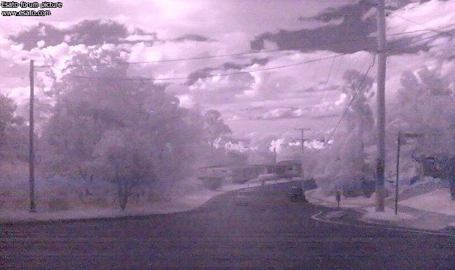

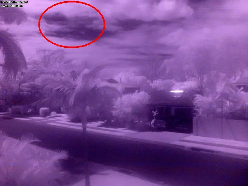

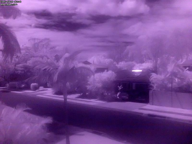

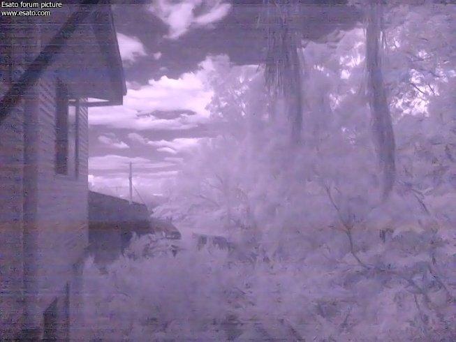

Here are my results below. The pictures have been resized and had noise removal applied, and in some cases brightness has been adjusted, but NO colour filters were used in post processing. What you see here are true Infrared photos. You are looking at the subject in a way the bare naked eye never sees.
The pictures are grainy even with noise removal, due to the fact the camera has had to boost iso to capture what little IR gets through the IR cut filter. I also had to use night mode (even though the pics were taken in full daylight):
(note how dark green foliage comes out snow white, and the sky comes out black):

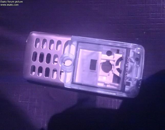

Another freaky feature of IR, is that anything that is opaque for visible light but invisible to IR light becomes see-through:

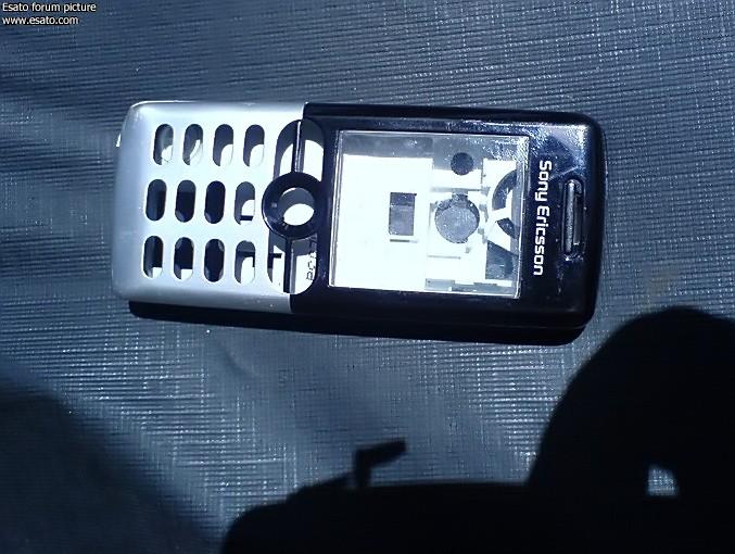

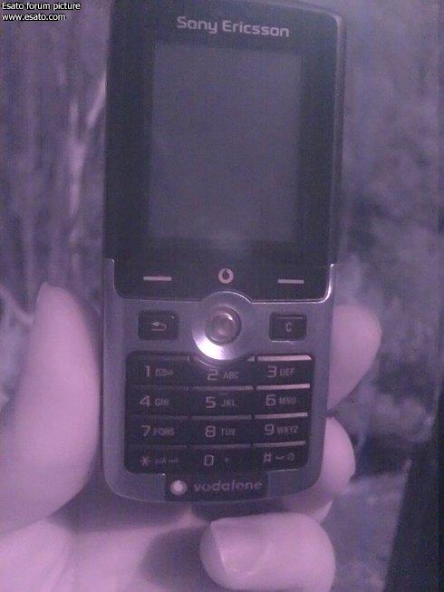

T610 cover in visible light:
T610 in IR light:
My sis's K750 looks like a T610 in IR light. The black paint on the front casing is completely invisible to IR light, showing the metal underneath:

dont work on my K750  |
max_wedge Joined: Aug 29, 2004 Posts: > 500 From: Australia PM, WWW
won't work under normal lighting or indoors, must be outside in bright sun light. (or you must use a source of IR light such as Tungsten lighting or an IR led torch).
Must also be the Black exposed part of the film strip, not the clear part.
This is not susceptible to firmware issues it'll work on all K750's if you get the technique right. |

Wow! I freaked out by the 'death' / 'paranormal' of your first pictures! What do you exactly mean by: "You are looking at the subject in a way the bare naked eye never sees. "'?
How is it? White? Colorless? I don't understand...
Please explain as I liked the idea! Thanks!!

Dan, they are freaky looking pics alright! Also sort of serene in an "other worldly" way.
What I mean by the naked eye is that the light frequency that is reflected in those pictures contains hardly any visible light, so it's a perspective of looking at the world that your naked eye would never see without this trick..
For example notice how the Dark green foliage is White, and most black paints or dyes are invisible so you can see right through (the K750 front). Black material for example is usually white (the black dye becomes invisible). Yet white things are still white, so it's not just a special effect like negative colour for example - it is an actual image made up of reflected IR light
The image that reaches our eyes of the world around us is made up of reflected visible light, so we don't see things the way they really are, because not all light is visible. IR photography reveals a slice of that hidden world.
