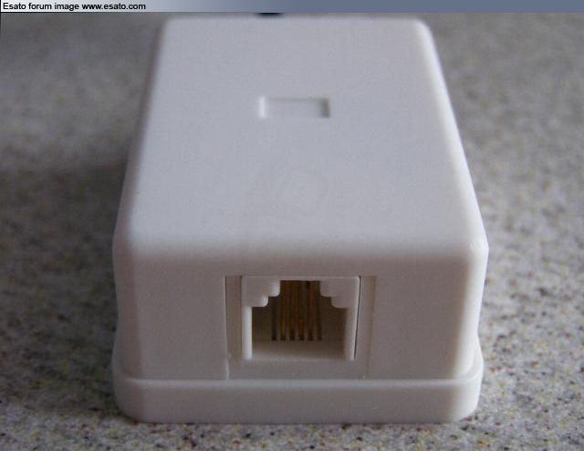

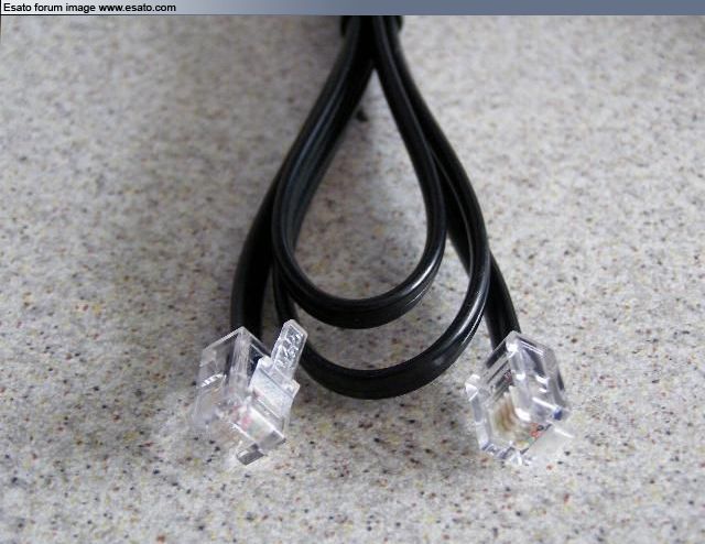

The RJ45box is ordinal telephone box/cable... You need this if you want to make the service cable 2 in 1... To work with newer (fastport connector sony ericsson phones) and with older (DB2000 phones) too...
RJ45 Box:
RJ45 Cable:
You can also connect the K750 connector to the RJ47 cable and connect the cable to the TxD, RxD and etc... directly without using the box... But that way you will get only "fastport " service cable

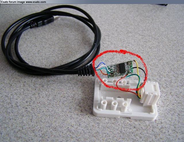

da USB part of DCU-60 is connected to the phone box but wat is that chip??

That's the electronics from the K700 USB cable ... OR simply said "the part that makes this cable "service cable" "

i dont have a k700 cable... only a cable for k750 n up... all those with fastport
the DCU-60 cable. can i still make a service cable with DCU-60 cable cuz i dont have any chip in the middle is a plain

P.S. THe service cable cannot be made without the K700 cable part, because that electronics are "the service cable"...
Btw If custom cable making is too complicated and you don't have needed parts, you can buy yourself a cruiser cable (+it will be useful to you for your further SE phones)
